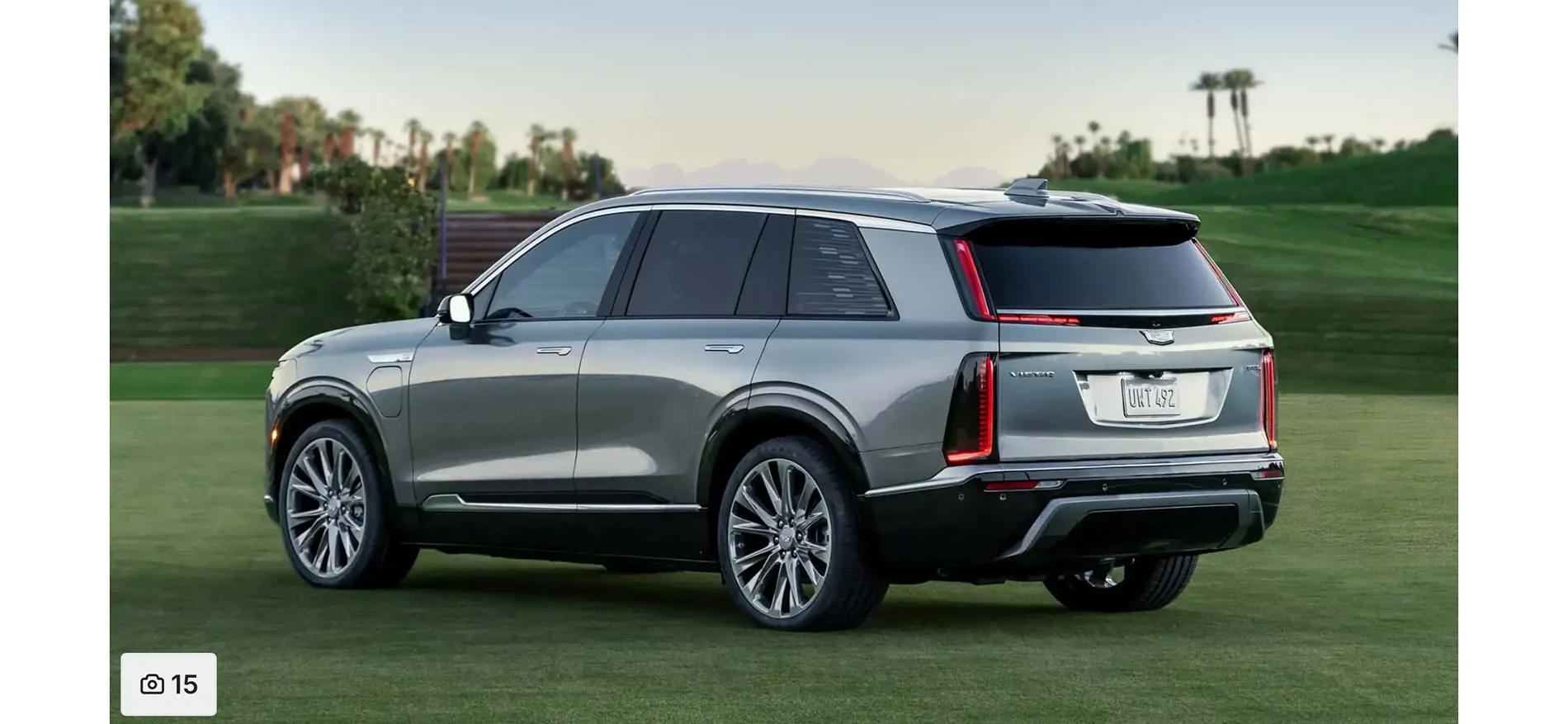

Man I grew up in a garage my first car was a 62 Colony Park Station wagon and restored many . Had Porsche targa 77 track car 996 vettes 3 , bmws , mercedes , trucks but since getting older 66 I don't miss getting in and out of the vette's This Cadillac VISTIQ is size of a Tahoe and rides like a Cadillac and is faster than my corvette and I don't miss the rumble and the maintenance that came with um. Look at it this way when your heart stops do they pour miracle mystery oil down your throat or hit you with a charge of electricity.
