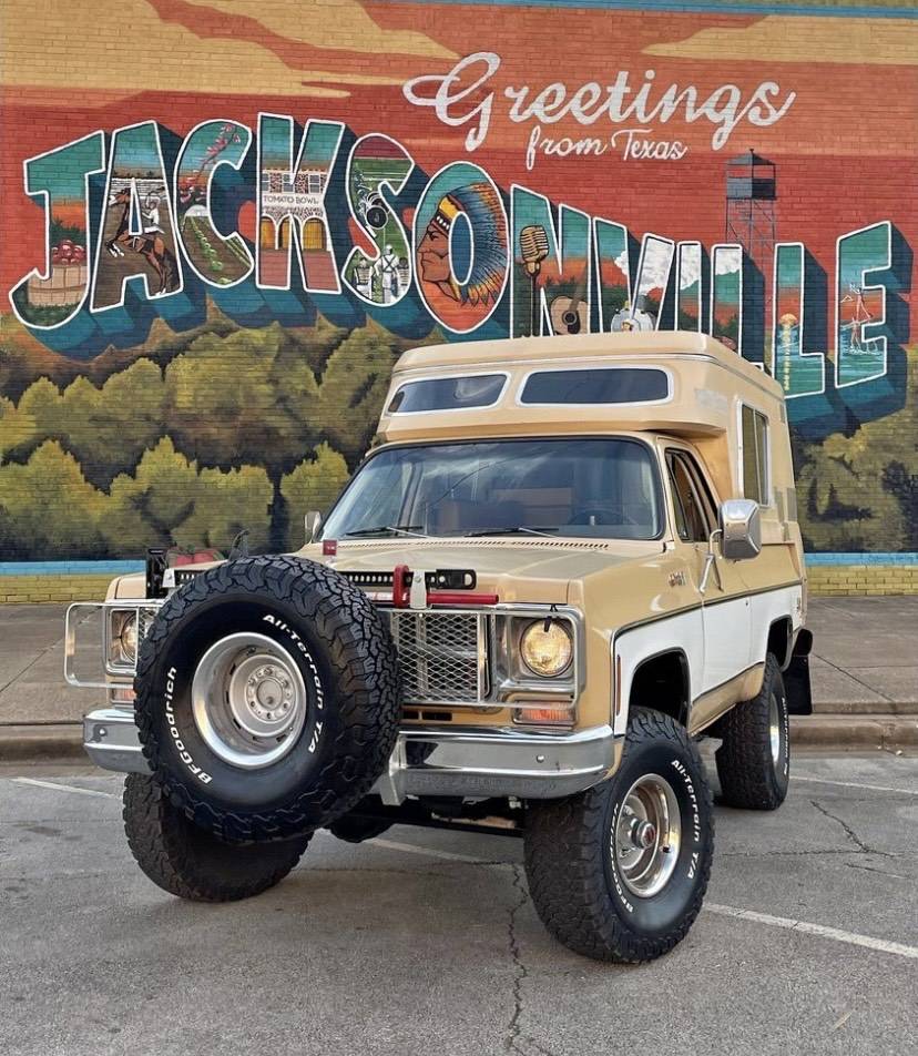

could always go old school and do the front mount spare. it could tilt down or swing to the side. ?‍♂

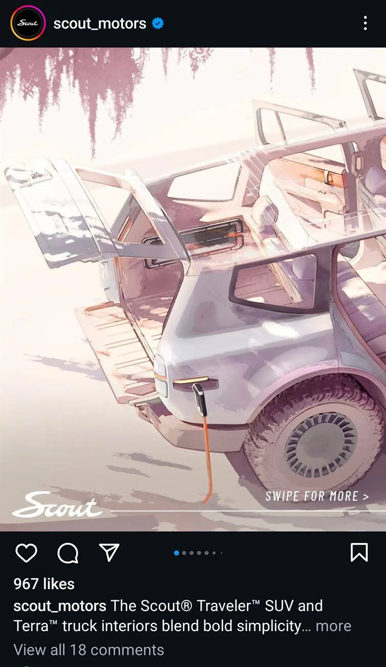

Based on this, it looks like the rear tire carrier is absent.
928
It’s gonna be detachable. But I’m sure it will be an option too from what I've seen and have been told.
rfk
71
Great find - love the split tailgate and don't want spare tire in the way. Better underneath or inside.
But now that I think about it, shouldn't charging port be on driver's side?
928
At the reveal the charge port was on the drivers side. This is most likely a very early sketch.
