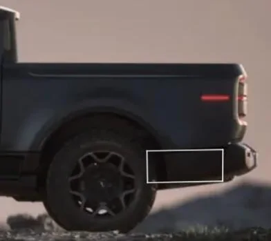

Assuming the tire is a 35" (for reference to scale). An engine AND generator is going to fit here...?

Assuming the tire is a 35". An engine AND generator is going to fit here...?

It will be interesting to see where they put the spare in the Terra. For the Traveler, a 33-in spare should fit in the BEV where the Harvester would go. I think the Harvester Travelers will have to put the spare in the cargo area or the external carrier.

I meant the tire on the rear axle is 35" for a perspective of the scale of the location where the engine and generator are supposed to fit.
I hear you. There been a lot of posts about Harvester and packaging lately that just got me thinking about the spares. Scout engineers are definitely earning their money!
