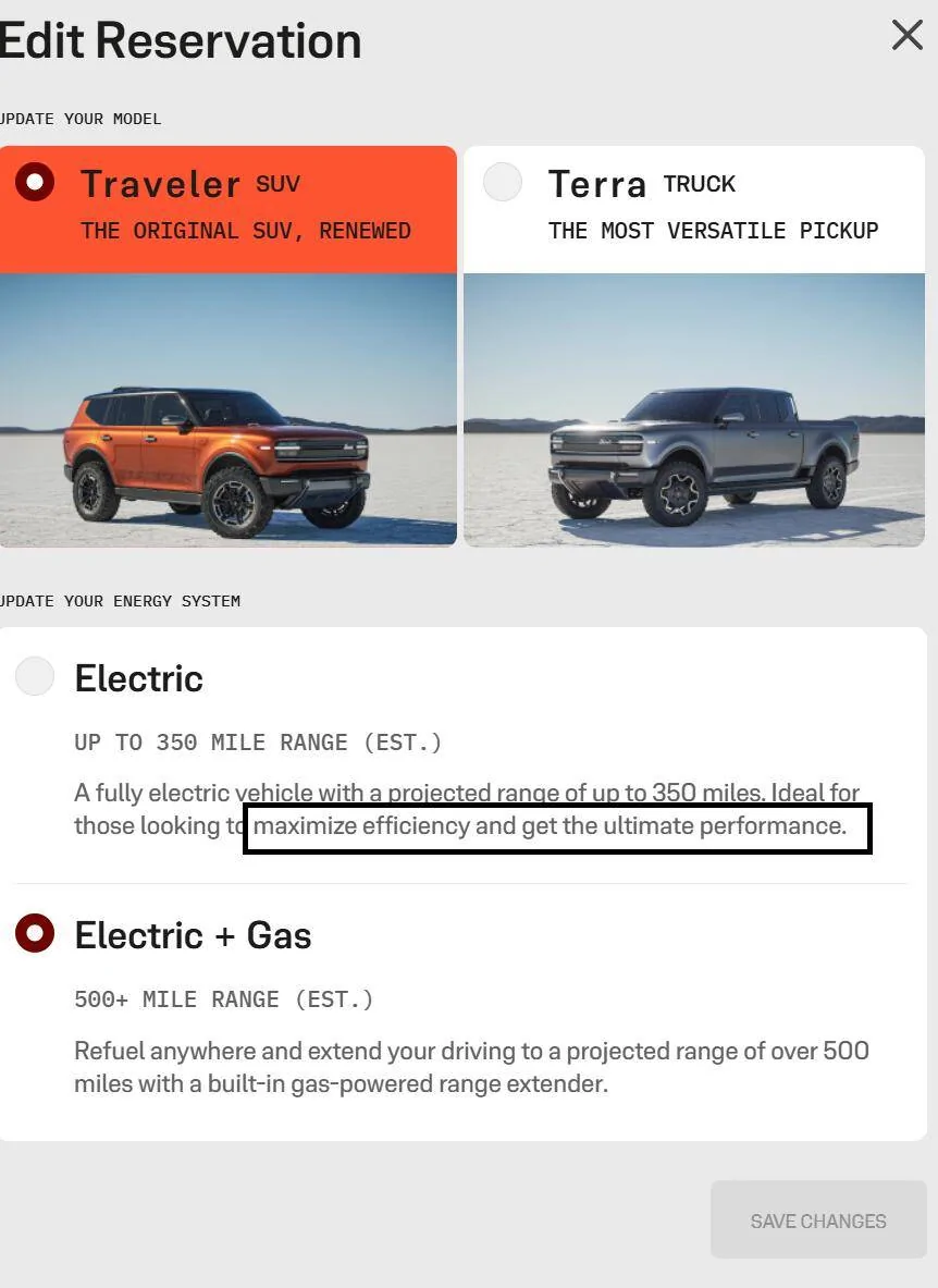

I've opted for the Harvester configuration. Based this reservation detail, I suspect the power may be down a bit in addition to the smaller battery. However, having no range or charging anxiety is a win. I also have already suffered the massive depreciation on my Two Mach-E's....I see a EREV as being the sweet spot for giving me what I want with an EV while allowing me to keep value in the vehicle as it would be a more appealing option to a wider audience.

The key question is: can you just keep filling up the tank on a 12 hour / 700 mile drive, or do you HAVE to stop and recharge?
I don't own a BMW i3 with range extender, but I have seen a number of reviews on it describing how it works so I'll try and make a guess based on that.
The vehicle would use battery only to a set percentage (hopefully customizable), then the harvester kicks on to provide enough power to meet demands and keep the battery level from dropping further.
The gasoline engine would almost certainly vary RPM to change power output to reduce NVH so it's not really trying to charge the battery...it's trying to just match the average power demand you're asking of it.
For your scenario:
Realistically, you won't have 500 miles of range for highway driving...that would be quoted in the most efficient driving scenario, which is city driving....so let's assume you have a total of 400 miles range at highway speeds.
Let's make the assumption you will get 200 miles EV only range with the smaller battery. Then the Harvester gives you another 200 miles of extended range.
We'll say we want the Harvester to maintain battery at 50% SOC.
You start out at 100% SOC and a full tank of gasoline. You make it 100miles, the Harvester kicks on to maintain charge, and you get another 200 miles (300 in total) before you refuel. Now, you're just using the Harvester. You've got 200 more miles before refueling.
For 700 miles you're refueling 4 times (@Start, @300 miles, @500 miles, @700 miles) and reaching your destination with 50% SOC and a full tank.

Thanks so much for the well laid out explanation!
I'm happy to hear that I wouldn't have to park and charge as I'd feared, but a bit disappointed that it would mean 3 fuel stops compared to the one 1 make now with my Grand Highlander Hybrid Limited (4cyl w/battery gets 33MPG).

Ramcharger has 130kw generator with that V6 so it's capable of producing up to 175ish hp....I suspect Ram sized the generator to be able to keep up with towing demands.
If the Scout has a 3 cylinder and we very roughly estimate it has a generator half the size as the V6, at 65 kw that's 85hp which is definitely enough as an average to keep speed on the highway for most vehicles NOT towing.
I really think the key to all of this is going to be if we can have a target charge that's customizable. If you have a target charge at 50% you have some room to open up some thresholds for an acceptable variance of like 5%. I would think the system could use some algorithms to determine how much power you're using and scale how much it will let you have on demand to try and maintain that target.
If you can't set that target and it's fixed at like 7% SOC, there's not a lot of room for error there and I would think they would HAVE to limit your power output like they do with the BMW.

The BMW i3 from 2016 had an EREV setup (but horrid battery life). The only other existing vehicle that has it is the 2025 Ram 1500 Ramcharger. That's got a 92 kWh battery, 130 kW generator paired to a 3.6L V6 engine.

Let me help a bit. Hybrids are divided into two architectures: (a) Parallel Hybrid and (b) Series Hybrid.
Parallel means the gas motor (it can be gasoline or diesel) runs in Parallel with the electric drivetrain to power the electric motors and charge the battery and has a mechanical connection to the road wheels. There are several sub-variations of the Parallell hybrid system.
A Series Hybrid means the gas engine operates to create electricity that powers the electric drive motors and charge the battery. The gas engine is not mechanically connected to the road wheels. It's called "series" because the engine-powered electric generator has to make electricity first before the car will move. Make electricity first means the generator either supplies the electric drive motors with power or charges the battery, or both. It appears the Harvester architecture will also be a PHEV (Plug-in Hybrid Electric Vehicle), which means it can be plugged in to a charger to charge the battery in advance of the engine-generator supplying power to the electric drivetrain. Once the battery reaches a predetermined level of energy depletion the engine-generator starts and begins powering the electric drivetrain.
So, the Harverster hybrid will be able to run indefinitely on the engine-generator as long as there is gasoline in the fuel tank. The impact that results is a lower overall eMPG (equivalent Miles-Per-Gallon) rating because internal combustion engines are not that effective turning the energy stored in gasoline (or diesel) into usable power. They are known in physics/engineering parlance as "heat engines", which results in the power converted during the combustion event in the cylinder being mostly lost as heat. But using a gas engine to generate electricity is more efficient use of gasoline (or diesel) because the EV drivetrain is very efficient and loses little heat as it converts energy in the electricity to motion.
Thank you so much for taking the time to explain that. So, it sounds like I’ll be a-ok to make the 700 mile trip without plugging in, which is a big relief. Love the design, bench seating, retractable roof, etc. but just needed to make sure it won’t make my monthly 12-13 hour journeys unbearable. Thanks again!
