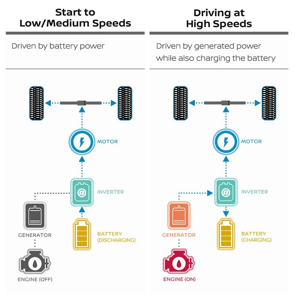

Except GM (Volt) and BMW (i3) and Nissan (ePower) have already done it this way. The inverter acts like a router for the power coming from the generator. Routing the generator power to the drive motors preferentially, depending on demand, any excess power gets routed to the battery, any deficit gets supplied by the power already stored in the battery. Less conversions from A/C to D/C or D/C to A/C, more efficient.
From Nissans website
Listen to the Nissan engineer explain it

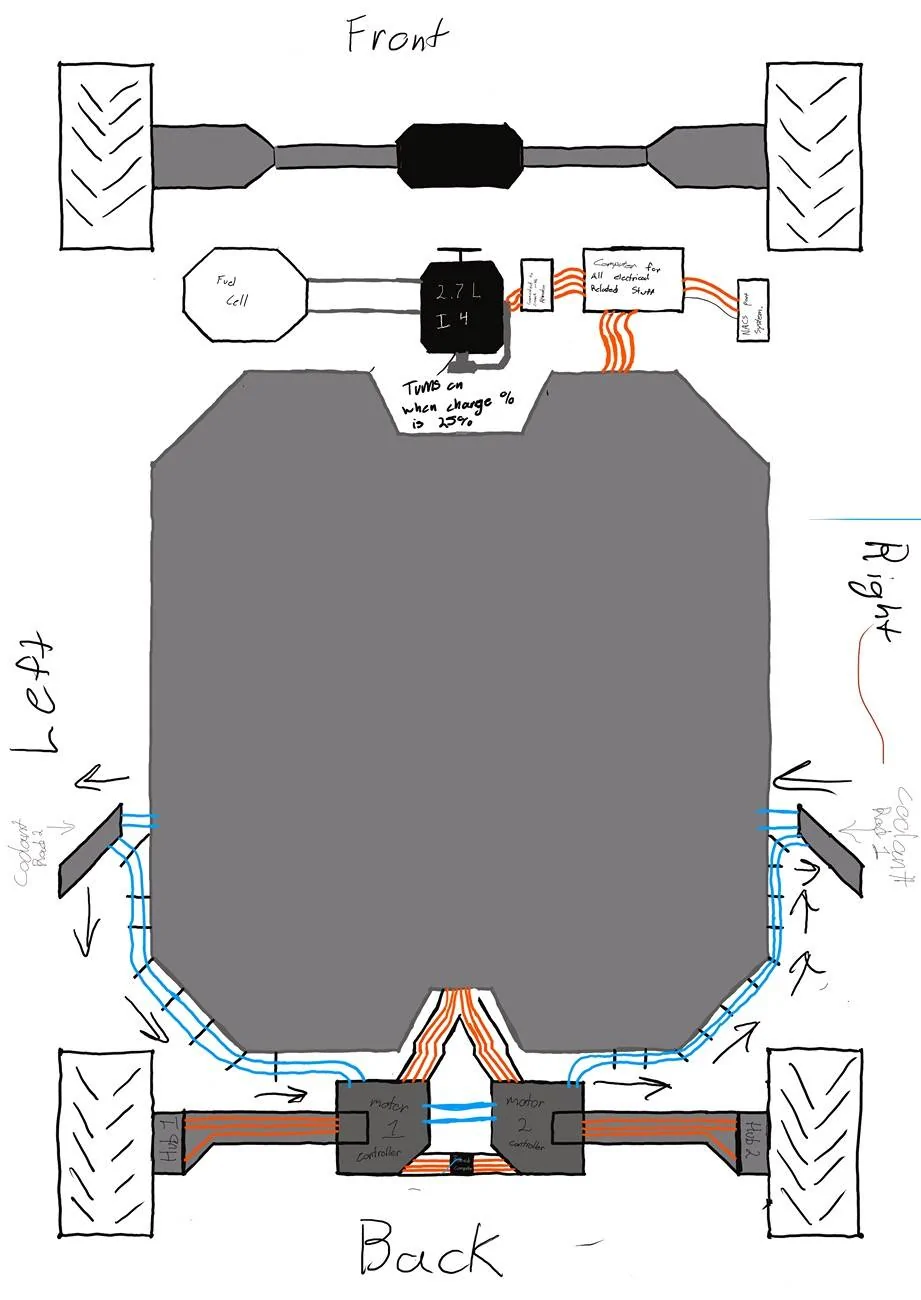

928
I’m gonna draw up a diagram from a mechanics POV. Which is something we learn is on how to draw powertrains
928
Obviously this is not what the Scouts architecture will look like. But the concept is there on how the Harvester will work. This is from an old project that me and a bunch of friends were working on before we decided to quit from working on it.
basically how it works is the battery will be used until a percentage that will be programmed into the software Most likely. At the percentage that it’s programmed for the Harvester to kick in and begin to charge the battery. In a few shots of the OS it looks like there will be a tow mode(only time will tell what that will do).
